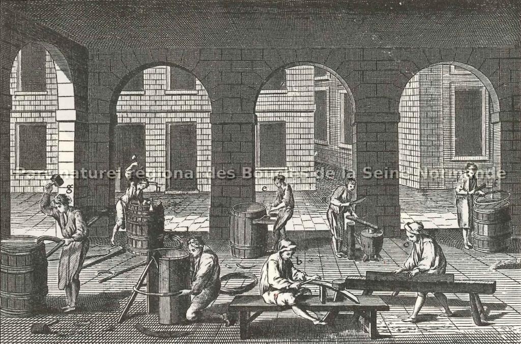

PostPosted: 20/11/2019 15:53:29    Post subject: art de la tonnellerie Reply with quote
petite image intéressante
